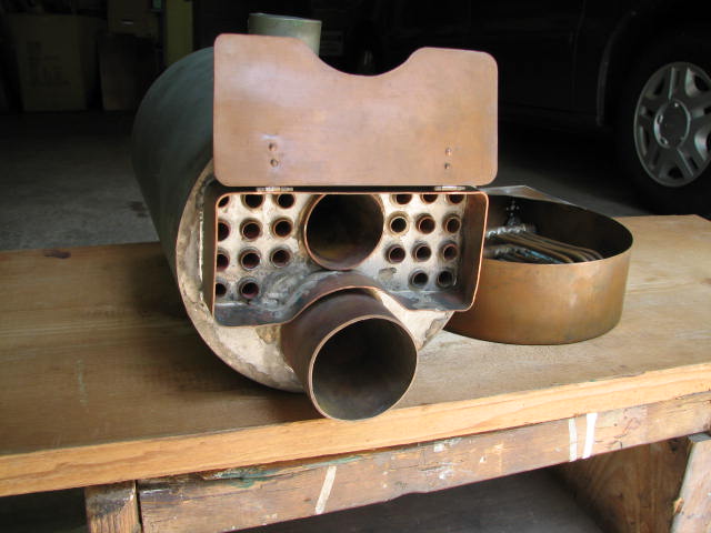

The end cover for the boiler has a manifold which is a superheater or an economizer. The tank on the engine is also an economizer used as a feed water heater which takes the place of the real life condenser.
We found out early that boilers in scale are hard pressed to furnish enough steam for small engines as nothing is efficient and we are dumping the heat to the atmosphere. For that reason we planned for both use of flue gas heat and exhaust heat to assist.

Very nice work! Thanks for sharing. The lube distributer looks great. Am I right that the circular tank next to the boiler with the tubes within is the feed water heater? Is it an economizer?

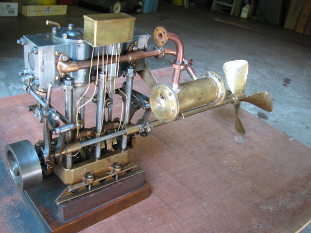

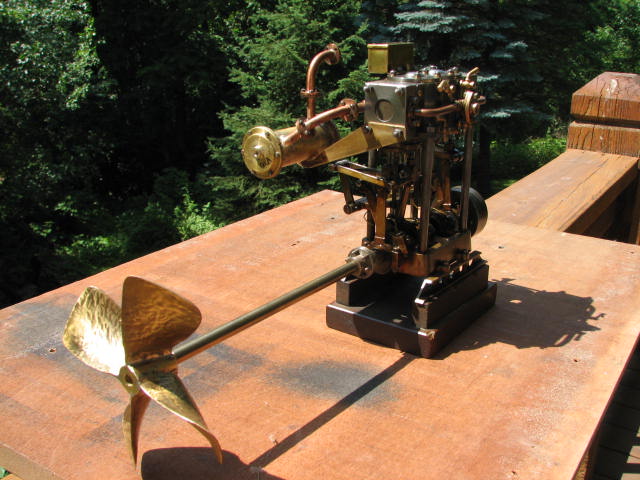

Here are some pictures of the Stuart Turner reversing twin engine
with feed water heater and propeller.

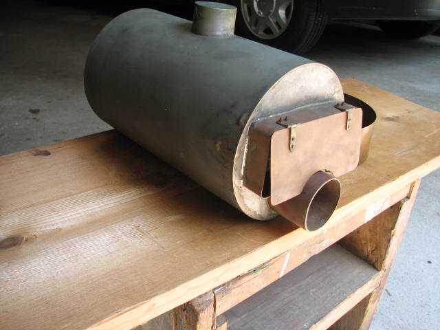

Boiler pictures here:

Boiler pictures attached as requested. Will post engine pic later

We have built a 6" dia 8" long Scotch -Ingliss type firetube boiler and plan to use liquid fuel although butane is also possible. Pictures are available if you are interested.
The Boiler is from Harris book on boilers and has a shell of 1/16th Monel. The feed pump is engine driven with a worm gear reduction to a 3/8" bore plunger pump, drives in either direction from a cam.
Feed water heater on engine exhaust looks like a condenser, removes oil from condensed steam. Water is dumped as tanks in bow and stern are large enough for several hours running.

A twin is best as it is self starting for R/C with 90 deg cranks. compound is 180 deg and has dead spots. If you wish I can send you pix of my engine if you send me your e-mail address.
The Stuart Twin is best bet for larger models, fits 48 to 60" quite well. Machining time is about 250 hours though.

Just working on a Stuart Turner Twin for an R/C Tug in 3/4" scale.
