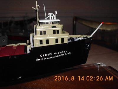

Ok, we've got them all now, thanks to a friend of mine. I had done a little commentary on the Victory and Carnahan conversions earlier, and just wanted to put in a few words on the Thompson. The third and last of these labor of love jobs was by far the most extensive. The only thing I was really able to use from the hospital ship model kit was the aft third of the hull, a must because of that unique configuration. A portion of the forecastle deck and prow of the hull was used, and even that needed modification with some putty. Pretty much everything else was fabricated with sheet plastic, index cards and a few pieces from the parts box, notably the 2 gun tubs from an old destroyer model cemented together that were used for the pilothouse, and the stack fashioned from 2 old nose parts from an airplane (P38?) model.
It's a good thing I did this one last with the experiences of the first two as it probably would not have turned out as good as it did. I knew C4s, and the Thompson was my fave of the C4 conversions. I did have a chance to wheel a C4 out of Midway Island's harbor. She was none other than the USNS Gen H. H. Arnold, a converted C4-S-A type serving as a missile tracking ship in the Pacific in the mid-70s. Unforgettable in all white with those 3 huge radar dishes, she was a lumbering thing. Her and sister Hoyt S. Vandenburg were frequent visitors for logistics.
I hope everyone enjoys the pictures. They were fun projects.

Thanks, guest. The lettering is all from dry-transfer letter sheets I've had laying around for years. Applied with a pencil-rub by eye, then clear-coated.
I went thru what you mention about the older kits. And the new reissue kits, besides being made in China, show tooling mold wear with a lot of flashing to be trimmed and details lost. It's worth the few extra bucks to get an original or older issue of any kit if you plan to build it, the details and molding are crisper. I did this with the T-2 ships and a bunch of AMT 57 Fords. More to come.

In considering the building of the Cliffs Victory from the Revell kit, I'm likely to build it to its original converted configuration with the plan to display both models in a side by side comparison. Where did you obtain the decals for the billboard lettering and the names?
