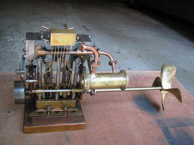

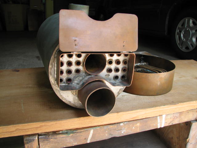

The end cover for the boiler has a manifold which is a superheater or an economizer. The tank on the engine is also an economizer used as a feed water heater which takes the place of the real life condenser.
We found out early that boilers in scale are hard pressed to furnish enough steam for small engines as nothing is efficient and we are dumping the heat to the atmosphere. For that reason we planned for both use of flue gas heat and exhaust heat to assist.

Very nice work! Thanks for sharing. The lube distributer looks great. Am I right that the circular tank next to the boiler with the tubes within is the feed water heater? Is it an economizer?

Here are some pictures of the Stuart Turner reversing twin engine
with feed water heater and propeller.

Boiler pictures here:
AR
Boiler with flue box incl. superheater

Boiler pictures attached as requested. Will post engine pic later
