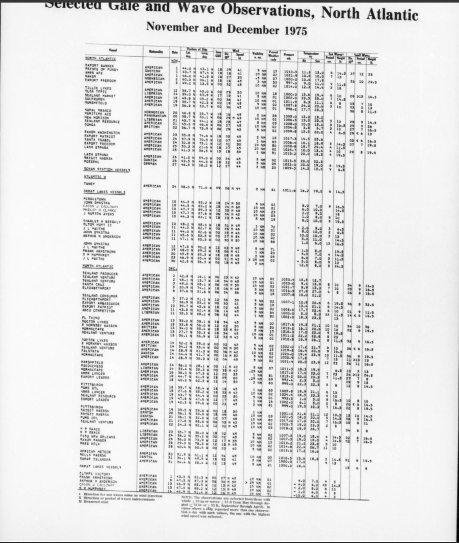

Interesting to see that out of the 26 ships outfitted to submit weather reports, 16 submitted the highest wind report of the month on the three lakes the Fitzgerald operated on: Superior, Huron, Erie. Of those 40 reports (some moths had tie records), 10 were from from the Fitz - more than any ship (Dykstra next with 4), which makes me think of Rick Mixter's claim that she was out in heavy seas more often than most other ships. For the monthly record of all the lakes combined, Fitzgerald reported 4 highest of the 13 months (tie in September).

Cansail wrote: April 23, 2023, 6:15 am Wasn’t the Middletown downbound the locks Monday afternoon?
No, the Middletown was out on Lake Huron on November 10, 1975. At 18 Zulu (1:00pm), she was at 44.5N 83.2W reporting winds of 50knots and waves at 16 feet.
Here's screen-capture from the Mariners Weather Log (1976, issue 3) showing the reports from various Great Lakes ships for November.
And here's a link to the online archive of the publication: https://archive.org/details/sim_mariner ... 3/mode/2up
Great Lakes coverage starts on page 139 of the publication.
- Brian
