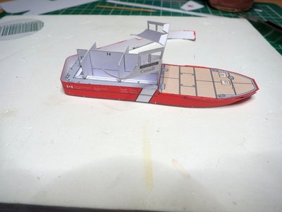

Another new cardboard model has been published as a free download at
http://www.papershipwright.co.uk. It´s the CCSG Cove Isle, whose sister ship, Gull Isle is presented here with lots of pictures for a perfect build. Right now my building report ist available for public in our Forum [url]
http://www.karton
- First steps in building the hull
bau.de[/url]
