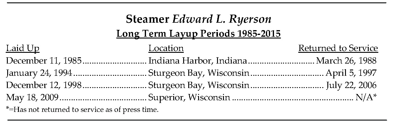

Shipwatcher News wrote:Also keep in mind that when she came back out in 2006 after spending 12 years in layup, her steam turbine plant broke down several times during the season. She has been laid up since 2009 this time, another 12 year period. Who knows how reliable her plant and boilers are going to be this time. She will likely have to be repowered if she will be back in service for any duration of time.
I believe you mixed up the number of years of inactivity in your first sentence as when the Ryerson returned to service in July 2006 it had been idle since December 12, 1998, so about 7 1/2 years, not 12. Currently, it is about one month away from this ship having sat idle for 12 years, its longest extended layup period thus far in its career. I have attached an image of a table in the book "The Inland Steel Fleet" that lists the Edward L. Ryerson's long-term layup periods starting in 1985. You are right, however, that it did experience some engine problems in 2006 after its long-term layup. It also had some minor issues when it returned to service in 1997 as well, one of which, if memory is not faulty, that prompted a stop at Milwaukee, Wisconsin. If the Ryerson ever does return to service without repowering, it is likely to have additional propulsion issues as is common with any mechancial device that has been unused for a prolonged period.
My mistake, you are correct. The one place I checked had her marked in layup from 1994 to 2006, but I now remember that she was reactivated in 1998. Should have checked another source, but thank you for sharing a correction.
