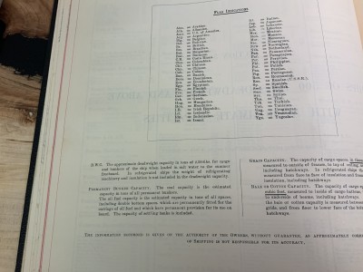

A note from Appendix to Lloyd's Register for 1952 gives the Deadweight tonnage to be given in tons of 2240 lbs.
EASTWATER 10 320
EASTWAVE 10 173
FEDERAL VOYAGER 10 354

Long tons have invariably been used in deadweight measurement by Lloyds and BC. Deadweight tonnage is a measurement provided the surveying authority from owners, according to Lloyds. Lloyds generally relies on state measurement of the more important gross and net tonnages used for toll and taxation purposes, which, of course, have no relation to avoirdupois but solely to cubic capacity.Would you agree that these deadweights would be in Long Tons given the dates

Thank you so much William Lafferty. Would you agree that these deadweights would be in Long Tons given the dates. I would assume so unless Canada used Short Tons to align with the U.S.
