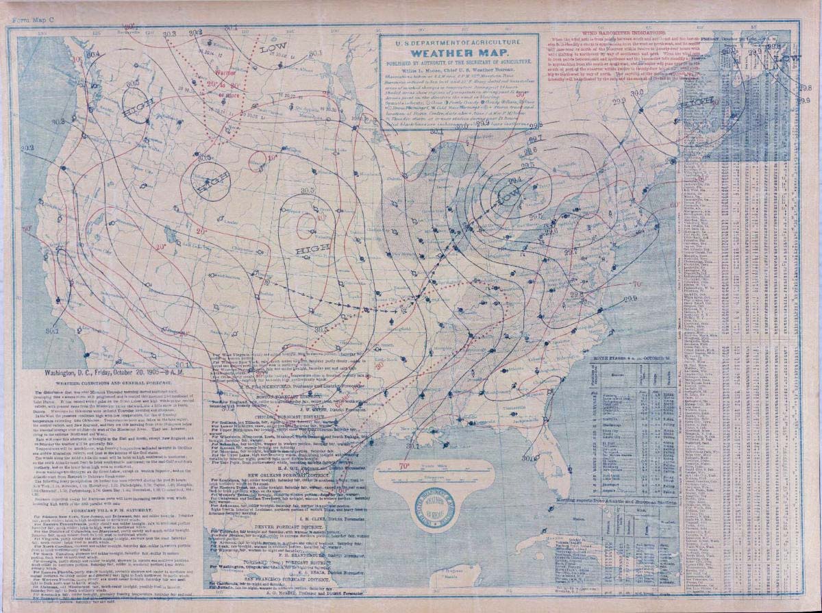

I grabbed the Daily Weather Map for October 20, 1905 from NOAA, converted it from .pdf to a .jpeg, did some editing in Adobe Photoshop to fix the white-balance and bring out the isobars for clarity.
It's hard to get the full picture of either system unless one does a full analysis as so much data is missing. One needs to use re-analysis datasets from Europe or NCEP, due to the scarcity of surface observations and the frequency of the maps. (Much is missed when you only have a 24-hour chart, as what happens between that time is often far more important.) I hope to do a numerical weather prediction model simulation of the November 27-29, 1905 system in the near future.
When you look at the November 27-29, 1905 and the October 19-20, 1905 systems, they are not unusual in terms of intensity based on my experience in meteorology.

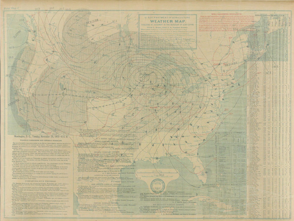

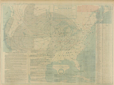

The weather map for November 28, 1905, shows winds from the northeast across most of Lake Superior, and with such a long fetch, the waves would grow in size, especially in extreme western Lake Superior - which is where the majority of the shipwrecks occurred.

Here's the Daily Weather Map from NOAA's archive for November 28, 1905.
