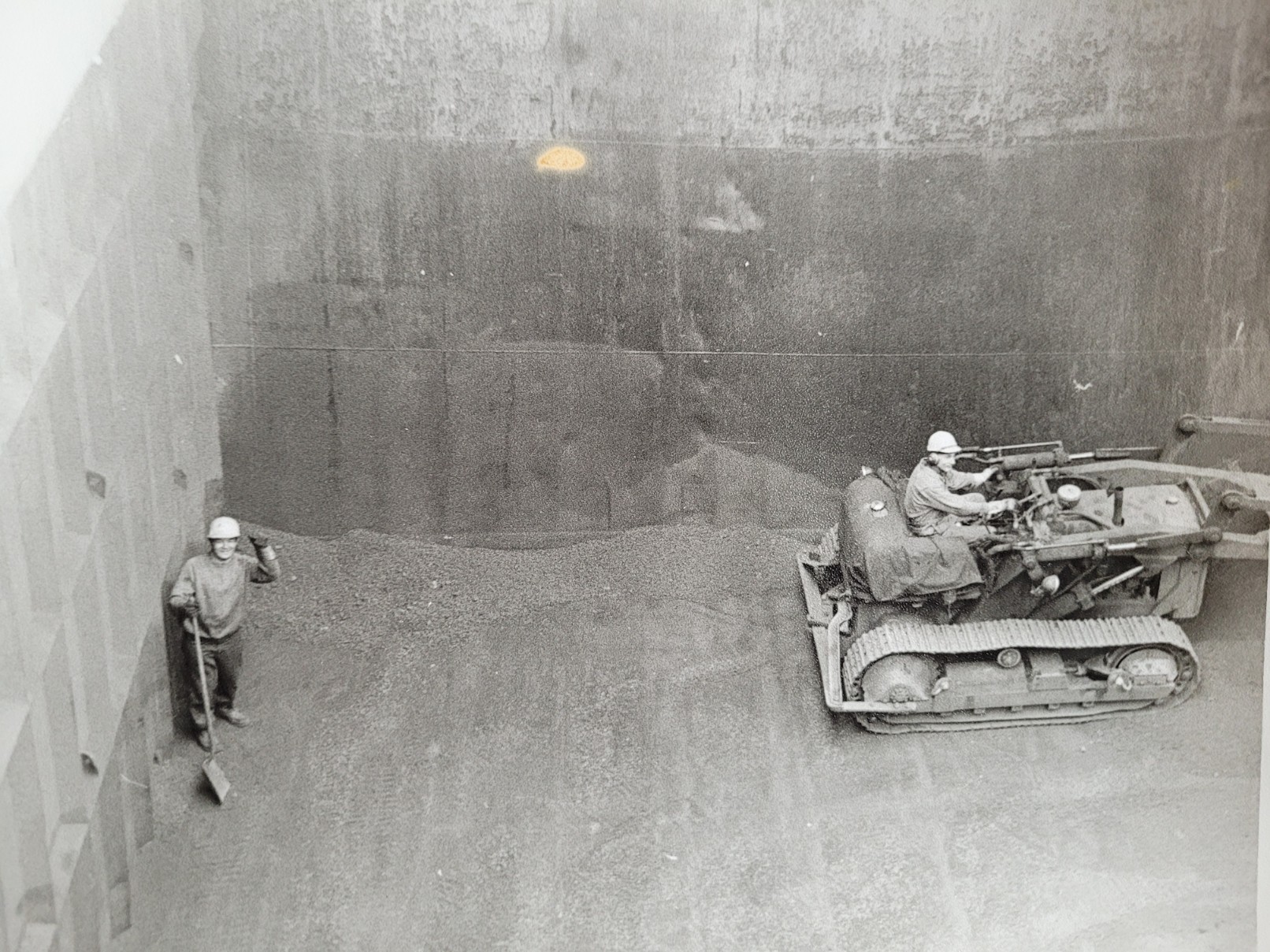

This was taken in the cargo hold of the Charles M White mid '70's. Its a diesel front loader and between the fumes and all the taconite dust it was a bit thick to breathe. No one wore masks and it was even worse when cleaning out for coal and using steel rakes to sweep the hold clean

In the "Olden Days" on the straight deckers, when they put the tractors and/or frontend loaders into the holds near the end of the unload, nobody wore masks. Those holds were pretty big and all the hatches were off. But it will be interesting to hear what some may say. It would not surprise me if today they did wear masks.

wouldnt the hatch covers be open to allow fresh air into the holds? or perhaps the front end loaders are battery powered. if in 1969 they could put a man on the moon im sure the rocket scientist have that one covered!
badger
Re: Loading Eqipment
Unread post by badger »
probably by the same way trains crews in a tunnel are protected
Douglas Bob
Unread post by Douglas Bob »
It's my understanding that carbon monoxide, a poisonous gas, is heavier than air. How are the front-end loader operators protected from the accumulated CO in the holds while unloading?
