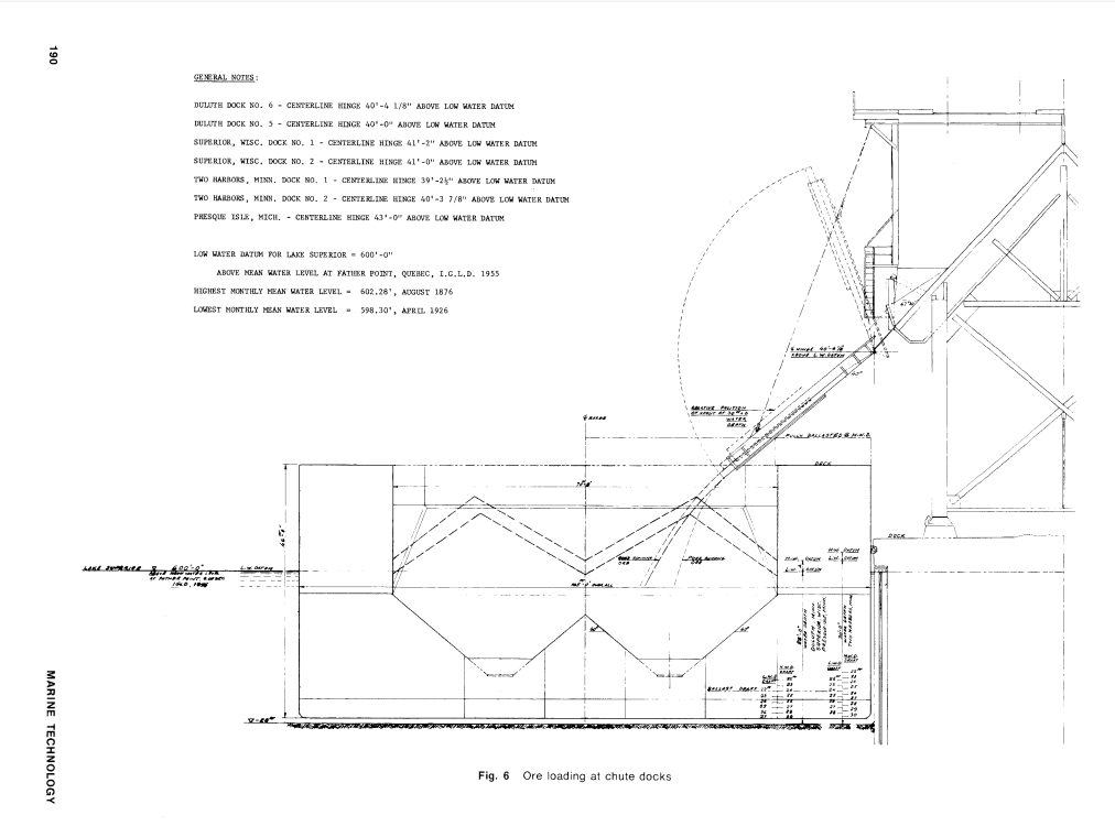

The shuttle loaders are efficient for all ships regardless of hatch size or hull depth, because ships are loaded faster, and they put less stress on a hull during loading because the loading is continuous. The gravity ore docks are outdated technology, but due to decreasing demand for iron ore pellets since 1980, there is no economic justification to spend money to replace them with new ship loaders. The gravity dock in Marquette is nearly ideal for the thousand footers with a 50 foot hull depth because they can fit under the chutes, while still having an angle of repose sufficient for loading. The distance from the lake level to the hinge pin on the chute at the LSIRR ore dock is 43 feet. Six-West at Duluth has a distance from the lake level to the hinge pin of the chute is 40 feet 4 inches. At Two Harbors that distance is 39 feet three inches for Dock #1, while Dock #2 North has a distance of 40 feet 4 inches. The LSIRR ore dock in Marquette has the greatest distance between the lake level to the chute hinge pin of all the other gravity ore docks

I've enclosed a diagram of a cross-section of the Presque Isle loading at a gravity ore dock.

It depends on the hull depth of the ship, the water levels and the height from the lake level to the center-point of the hinge hole of the chute.
The Presque Isle was designed for loading at the gravity chute ore docks due to her hull depth of 46 feet. The American Spirit, Mesabi Miner and James R. Barker can load at the gravity ore dock in Marquette, but they have to be ballasted and can only load on one side of the vessel. They have to either move to the other side of the ore dock or turn around so the opposite side of the ship can be loaded. That's because of the angle of repose of the chute. Too shallow an angle of the chute means that the iron ore won't flow into the ship's hold.
Vessels with a greater hull depth than 50 feet will have issues loading at the gravity ore docks because of their greater depth and the angle of repose of the chute.
