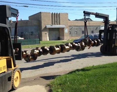

Guest wrote:They do have a Spare Crank. Being loaded to go to FM for check out / machining.
I can`t believe they picked up that crankshaft without a sling in the middle, unbelievable.

I wonder if this spare crank came from one of the replaced engines off the Paul R. Tregurtha?

Ok I think I found the specs on Colt-Pielstick it has 15 3/4" bore X 19 11/16" or 400MM X500mm to be exact. So yup that would definitely be the crank.
I was thinking it one of those low speed tall multi-level monsters. That's what happens when you've never been on-board to physically see overall size.
Straight cut, 3-part connecting rod neat to picture of what that looks like.

This crank doesn't look anyway as big as the cranks on "Paul A" post or did I pick the wrong Video I believe crank for an 8 cylinder

The crank is probably not a shelf item. To start from scratch - pour a slab, cool it and machine it, would probably take around 6/7 months.

Internet ad (with photos) for used Pielstick crankshafts. It kind of looks like the largest one shown is for a 14 cylinder engine, while the Barker has 16 cylinder engines.
http://www.industrialmarinepower.com/-1 ... shaft.html

Curious what dimensions of a crankshaft? Just what mechanics go thru just to get at the the crank, imagine lots cranes. Or are these engines have modular arrange to take certain sections or segmented crank ?

The Barker is in to replace a broken main engine crankshaft
