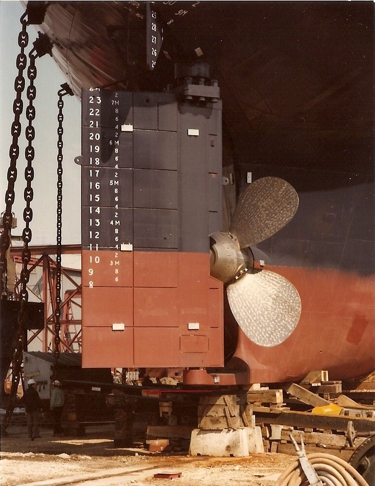

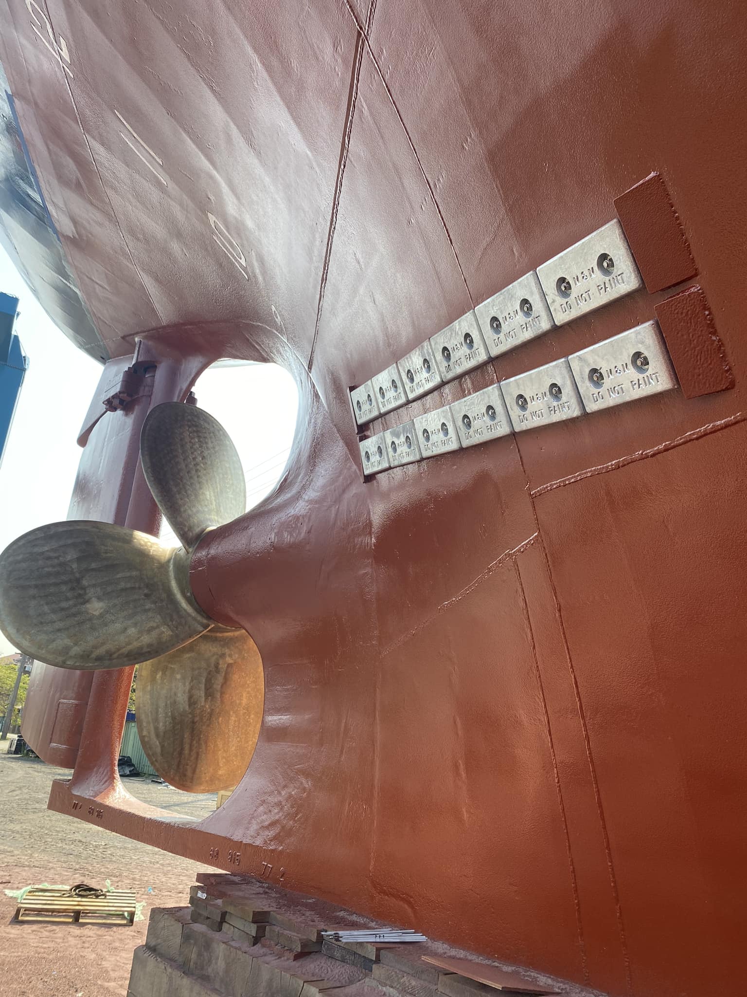

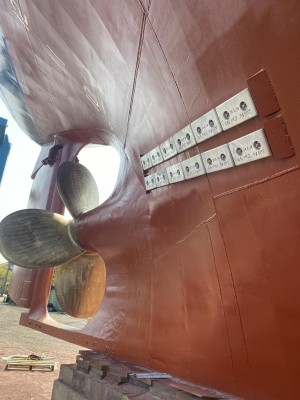

Confirmed anodes use used on Algoport & Bristol Bay - photos attached.
